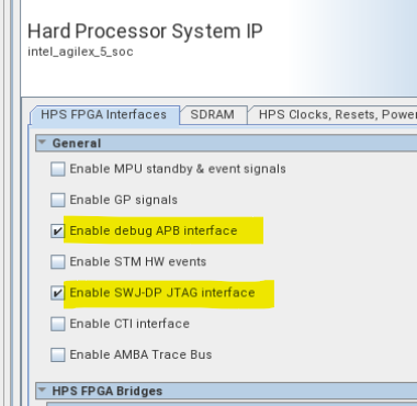

Due to a problem in the Quartus® Prime Pro Edition Software version 25.3, when enabling the Agilex® 5 FPGA Hard Processor System Coresight Trace it is not functioning.
Resolution
To work around this problem, enable either one of the fabric debug feature such as APB or JTAG and tie off the signals if they are not used.
