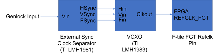

2. Use an external sync clock separator chip such as the TI LMH1981, to generate the FVH timing signal and feed the signals to the external VCXO (TI LMH1983) as shown in Figure 1. The TI LMH1981 external clock separator is available on the Nextera and Terasic 12G SDI-FMC daughter card and user has to supply the genlock input to the TI LMH1981 accordingly.
Figure 1.
