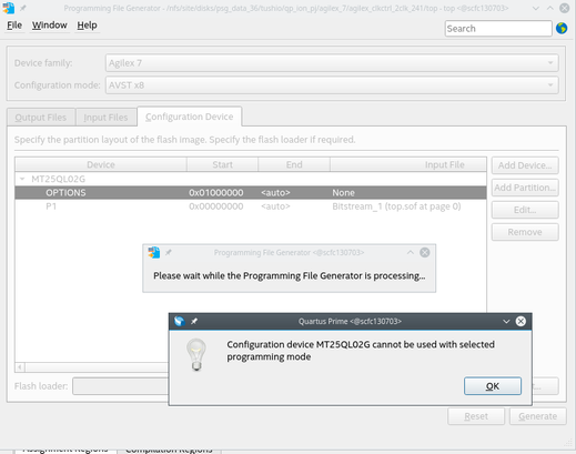

When one of QSPI Flash ROM devices is selected in the Add Device dialog to generate a .pof for AVST mode using the Programming File Generator, "Configuration device <device name> cannot be used with selected programming mode" will be issued.

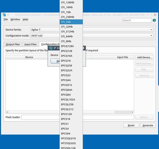

The Parallel Flash Loader II (PFL II) of the AVST configuration host supports QSPI flash ROM devices.  However, in generating a .pof for AVST mode, even when QSPI flash ROM is used for PFL II, an equivalent size of CFI flash device (CFI_<size>) must be selected in the Add Device dialog.
For example, even when MT25QU02G (2Gb QSPI ROM) is used, CFI_2Gb must be selected in the Add Device dialog.

< Error message when selecting QSPI flash ROM device in AVST mode >
< Add Device Dialog >

Select an equivalent size of CFI flash device (CFI_<size>) in the Add Device dialog of the Programming File Generator, even when AVST mode is used and a QSPI flash ROM device is used for PFL II.
