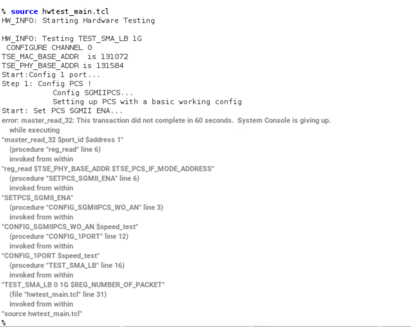

Due to a problem the reset connected to the Triple-Speed Ethernet Stratix® 10 FPGA IP Design Example JTAG module being incorrectly connected as active low when it should be active high in the 10/100/1000Mb Ethernet MAC (Fifoless) Design Examples with the 1000BASE-X/SGMII 2XTBI PCS with E-Tile GXB Transceiver.
Snapshot from the System Console:
