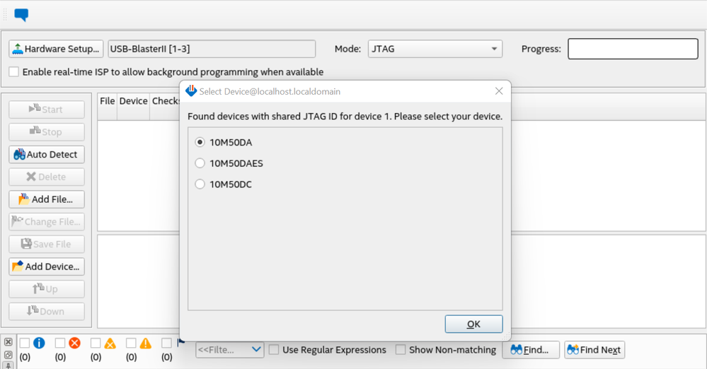

  • Click Auto Detect and select MAX® 10 device, click OK.

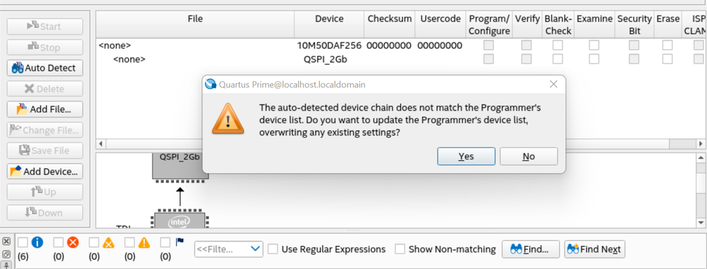

  • When the operation is 100% successfully completed, click Auto Detect.
  • Click Yes on pop-up windows.

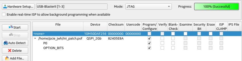

  • Check Program/Configure box of QSPI_2Gb, P1, OPTION_BITS and click Start to start the programming operation.
  • When the operation is 100% successfully completed, close the programmer window, shut down the platform (Pressing the on-off button on your server instead of typing “poweroff” in command window), set SW5.3 to OFF, disconnect USB Blaster II and boot the platform again.

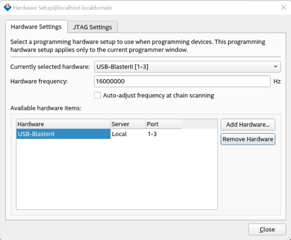

  • Click the Hardware Setup, and select USB Blaster II.
  • Set the Hardware Frequency to 16000000Hz and uncheck the Auto-adjust frequency at chain scanning box.
  • Click Close.

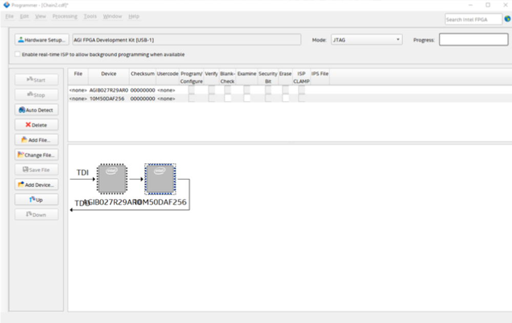

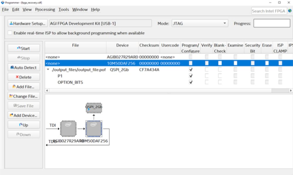

  • Click Auto Detect to scan the JTAG devices.
                            If the JTAG chain can not be detected, try setting SW4:3 to OFF.
                            If a device called 1_BIT_TAP appears between AGIB027R29AR0 and VTAP10, ignore it and continue to the next step.

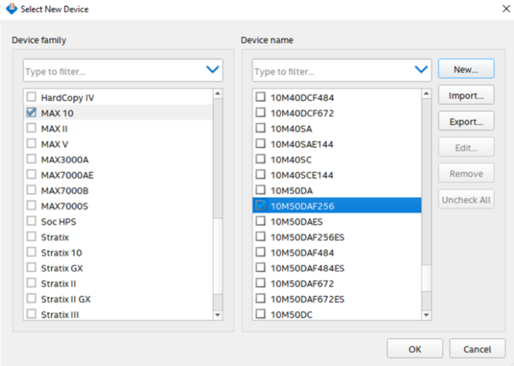

  • Right click the VTAP10 device, Edit > Change Device, change it to MAX 10 > 10M50DAF256.
  • Right click the 10M50DAF256 device, Edit > Attach Flash Device, select Quad SPI Flash Memory QSPI_2Gb.
  • In the Programmer page, click QSPI_2Gb > Change File to select the .pof file.
  • Start the Programmer.
  • When the operation is 100% successfully completed, close the programmer window, and shut down the platform (Pressing the on-off button on your server instead of typing “poweroff” in the command window), if SW4:3 was OFF before, set it to ON, disconnect USB Blaster II and boot the platform again.
  • Type “lspci -vt ” in the command window, 0ddb device should be found.
