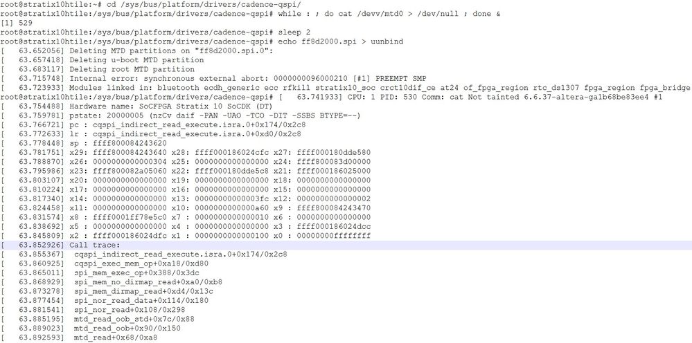

Due to problem in the SPI subsystem driver in socfpga-6.6.51-lts, the Power Management implementation was contributed by the open-source community. The qspi controller bind/unbind causes kernel crash/call trace issue while read/write /dev/mtd0 on Altera® Stratix® 10 SX SoC Development Kit.
