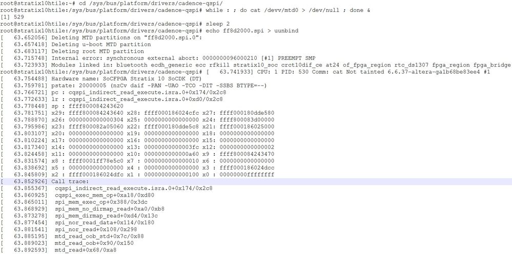

Due to a problem in the SPI subsystem driver in socfpga-6.12.11-lts, the Power Management implementation was contributed by the open-source community. The qspi controller bind/unbind causes kernel crash/call trace issue while read/write /dev/mtd0 on the Stratix® 10 SX SoC Development Kit.
