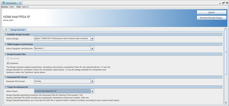

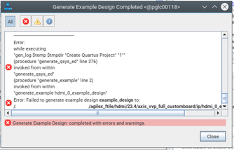

Due to a problem in the Quartus® Prime Pro Edition Software version 23.4, the following error will appear when generating HDMI FPGA IP Design Example when  selecting the board option to Custom Development Kit:
Tcl error: ERROR: Value "OSC_CLK_1_" for "DEVICE_INITIALIZATION_CLOCK" assignment is illegal. Specify a legal value.

Users can select the No Development Kit option instead of Custom Development Kit.
The generated design will remain the same, but the user must update the PIN assignment in the QSF file.
