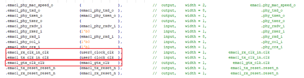

The top entity below helps to understand the EMAC clocks,  "emac1_gtx_clk" and "user0_clock_clk" used in the design, where EMAC1 is routed to the FPGA:
