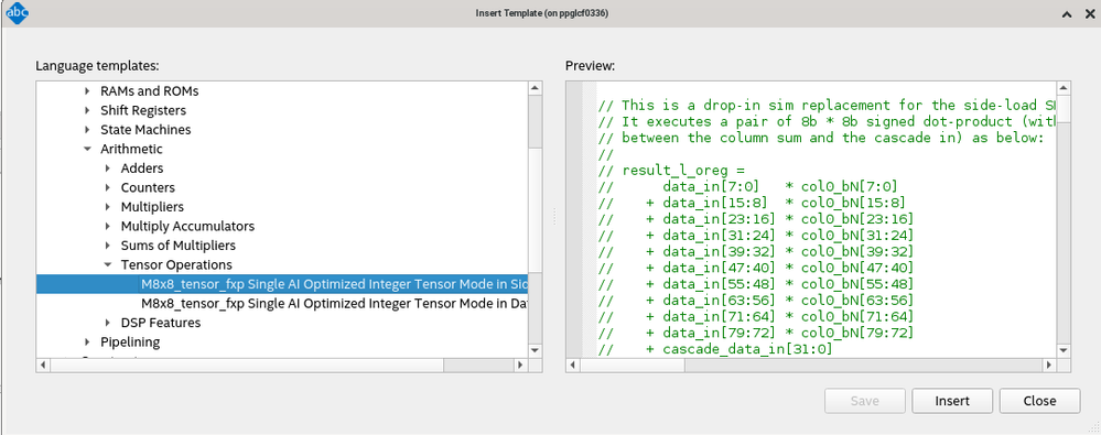

To work around this problem, fix the RTL to match the actual tensor mode operation, refer to the templates that are included in the Quartus® Prime Pro Edition Software, as shown below:
