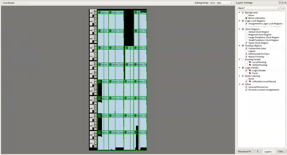

  • Open Chip Planner and select "Spine Clock Regions" in the Layers Settings tab.  For example, the Arria® 10 10AX066 is divided into 30 spine clock regions as shown below:

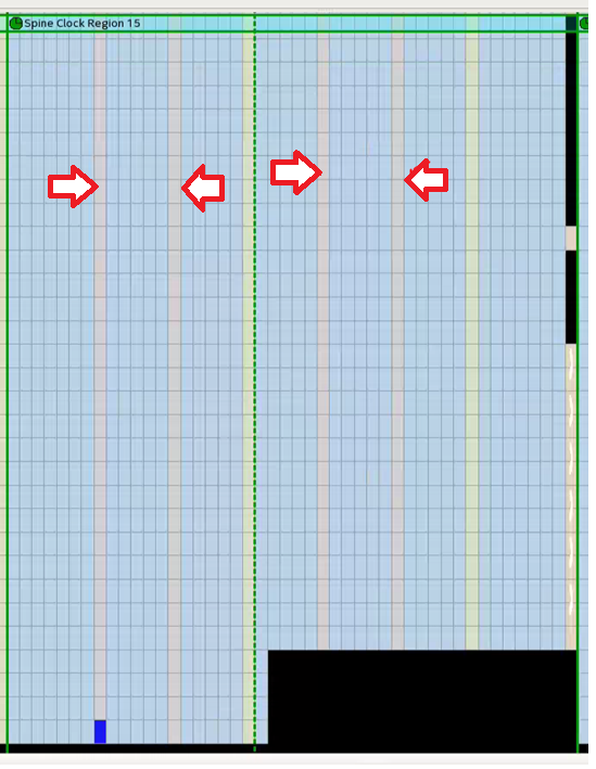

  • Zoom in to one of the Spine Clock Regions.  Each spine clock region may have 1, 2, or 4 DSP columns.  The number of DSP blocks and DSP columns varies in each spine clock region.  For example, see image below of spine clock region 15 in Arria® 10 10AX066 with 4 columns where the 2 longer columns have 31 DSP blocks and the 2 shorter columns have 27 DSP blocks.
