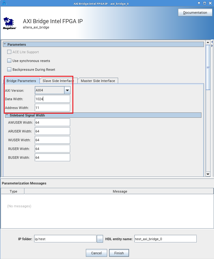

Due to a problem in the Quartus® Prime Pro Edition Software version 24.2 and earlier. You will see the error shown above when the Address Width is set to less than the correct minimum address width requirement in the AXI Bridge FPGA IP. The error will be  seen during the Quartus® Prime Pro Analysis and Synthesis stage.
Resolution
To work around this problem in the Quartus® Prime Pro Edition Software version 24.2 and earlier, follow the steps below:
  1. Double-click AXI Bridge FPGA IP in Platform Designer.
  2. Increase the Address Width in the Bridge Parameters for the AXI Bridge FPGA IP.
  3. Click the Generate HDL button.
  4. Save changes before refresh.
  5. Re-run the Analysis & Synthesis stage in the Quartus® Prime Pro Edition Software.
