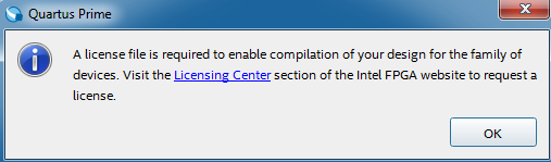

I would like to learn OpenCL, to do that I have installed Quartus Prime Pro 19.0.4 on my university lab, but it complains about no license.

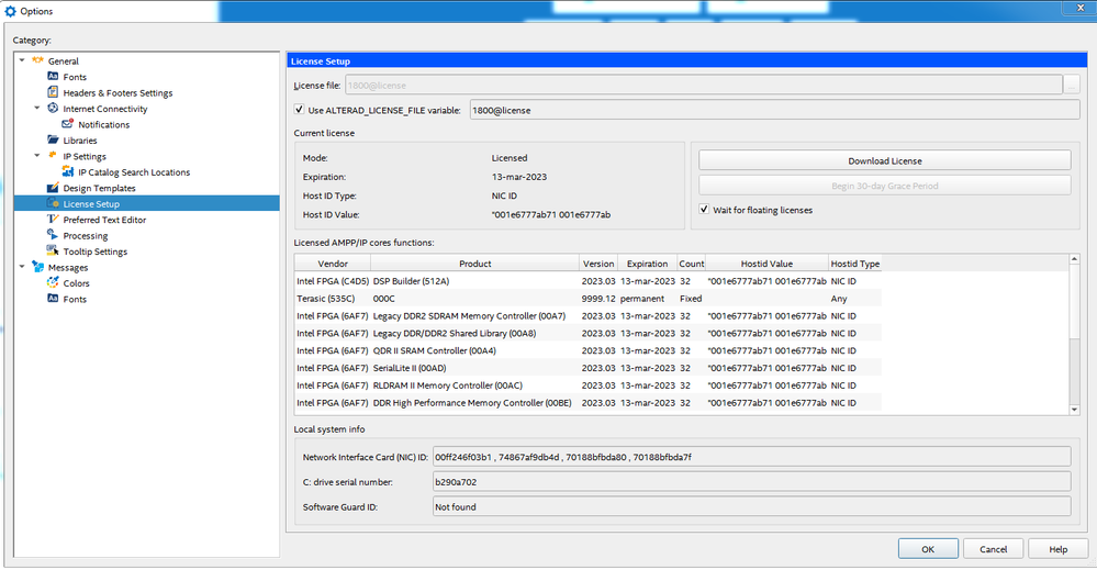

On the license server which Quartus is connected on, it has described the follow set of features:
FEATURE C4D5_512A alterad 2023.03 13-mar-2023 32 5A048B
FEATURE maxplus2 alterad 2023.03 13-mar-2023 32 0D3B79C
FEATURE maxplus2verilog alterad 2023.03 13-mar-2023 32
FEATURE maxplus2vhdl alterad 2023.03 13-mar-2023 32 A35
FEATURE quartus alterad 2023.03 13-mar-2023 32 8C3D8278
INCREMENT ip_base alterad 2023.03 13-mar-2023 32 696C4A
The picture bellow shows my Quartus licensed :
But when creating a project it complains about no license.
How can it be licensed and not licensed at same time ?

Could you provide the license file via email for further investigate?
Also, may I know the information as below:
- OS version
- Quartus Prime edition and version (based on my understanding, there is no Quartus Prime Pro in v19.0.4 according to https://www.intel.com/content/www/us/en/programmable/downloads/download-center.html)
Lastly, do you have setup the license file with steps according https://www.intel.com/content/dam/www/programmable/us/en/pdfs/literature/manual/install-license-quick-start.pdf in chapter 1.6.1?
