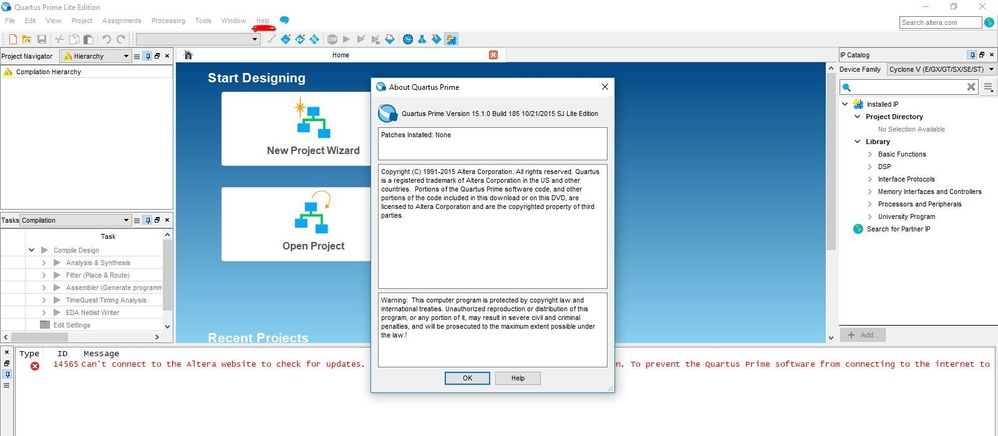

please provide the similar screenshot of your Quartus tool 'Help' menu-> 'About Quartus Prime', if possible.
If unable to do so, download & install new Quartus II web edition 13.0sp1 free from link below,
http://fpgasoftware.intel.com/13.0sp1/?edition=web
Vicky
