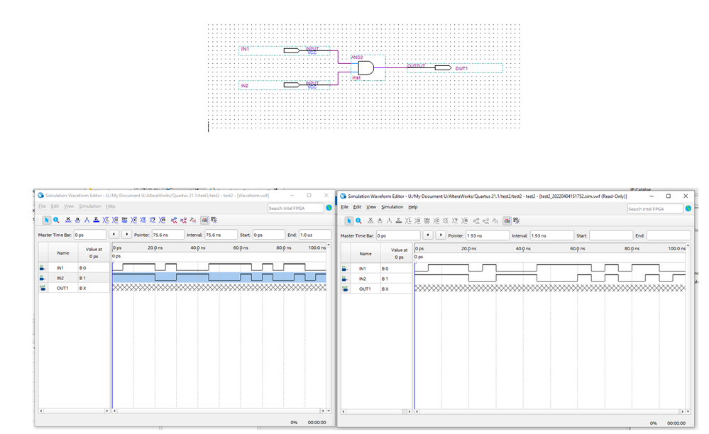

Output File is the same as the Input File Lite Edition 21.1
Hello
I have installed Rev 21.1 and when running simulation Output Input Files are the same.
In Rev 16.1 all good.
I would appreciate any help.

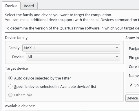

  • ShengN_altera's avatar
    ShengN_altera
    Select Auto device selected by the Fitter in Target device window for MAX II family then recompile and recreate vwf file. Next run Timing Simulation in vwf. I think you are selecting MAX II device which is not supported for vwf. Below attached a sample file for your reference.
    Sheng
    p/s: If any answer from community or Intel support are helpful, please feel free to mark as solution and give Kudos.
    • Nadavb's avatar
      Nadavb
      IT IS WORKING.
