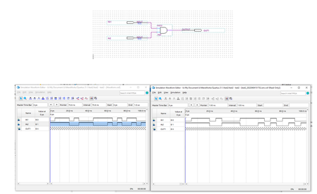

Hello
I have installed Rev 21.1 and when running simulation Output Input Files are the same.
In Rev 16.1 all good.
I would appreciate any help.
ShengN_altera
4 years agoHi,
Select Auto device selected by the Fitter in Target device window for MAX II family then recompile and recreate vwf file. Next run Timing Simulation in vwf. I think you are selecting MAX II device which is not supported for vwf. Below attached a sample file for your reference.
Sheng
p/s: If any answer from community or Intel support are helpful, please feel free to mark as solution and give Kudos.
- Nadavb4 years ago
IT IS WORKING.
