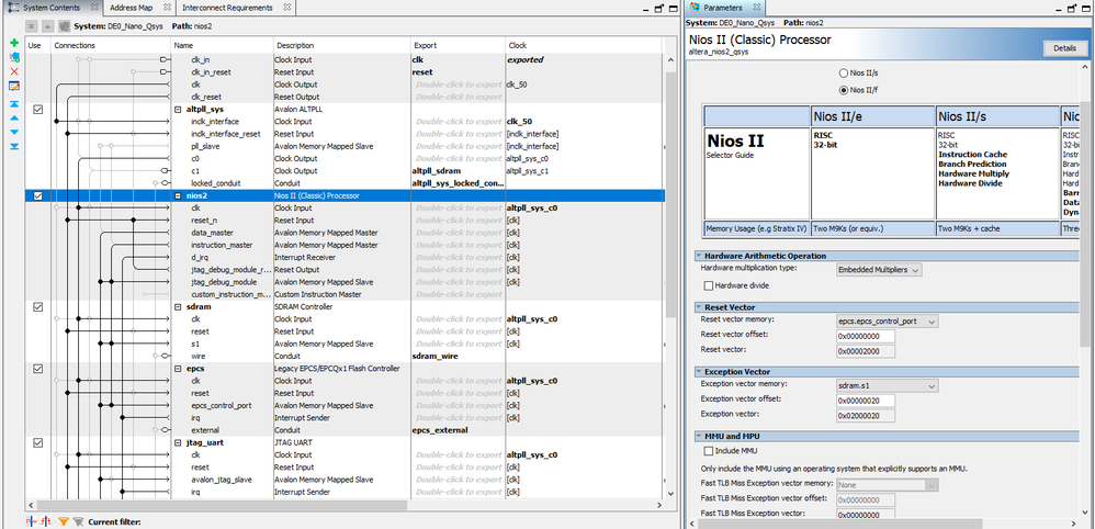

1. Qsys:
I've set the reset vector of Nios CPU to the epcs flash.

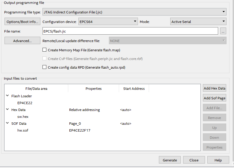

2. After I've compiled my .sof and .elf file, I opened the Nios II command shell and typed the following command lines:
- sof2flash --input=hw.sof --output=hw.flash --epcq --verbose
- elf2flash --input=sw.elf --output=sw.flash --epcs --after=hw.flash -verbose
- nios2-elf-objcopy --input-target srec --output-target ihex sw.flash sw.hex
3. Finally, I've compiled all of those files to a general .jic file to load into my EPCS.
However, after programming the .jic file, the Nios II program still not ran. Could anyone tell me how to solve this issue ?
