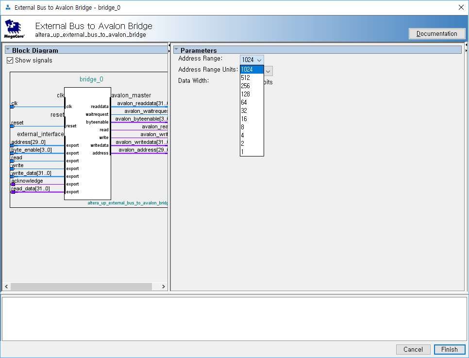

Datasheet provided says this:
Address—k bits (up to 32). The address of the data to be transferred. The address is aligned to the data size. For 32-bit data, the address bits Address 1−0 are equal to 0. The ByteEnable signals can be used to transfer less than 4 bytes.
However, what I could get is Address Range 1024 MBytes, which is only 30-bit address.
Is there any way to get 32-bit address width?

- SreekumarR_G_Intel
Sorry, Even though address bits are supported upto 32 bits, Address space for this specific IP supported by the bridge is 1024 MB max.
Thank you ,
Sree
