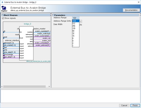

7 years agoExternal Bus to Avalon Bridge - Address Width
Datasheet provided says this: Address—k bits (up to 32). The address of the data to be transferred. The address is aligned to the data size. For 32-bit data, the address bits Address 1−0 are equal t...
SreekumarR_G_Intel
7 years agoSorry, Even though address bits are supported upto 32 bits, Address space for this specific IP supported by the bridge is 1024 MB max.
