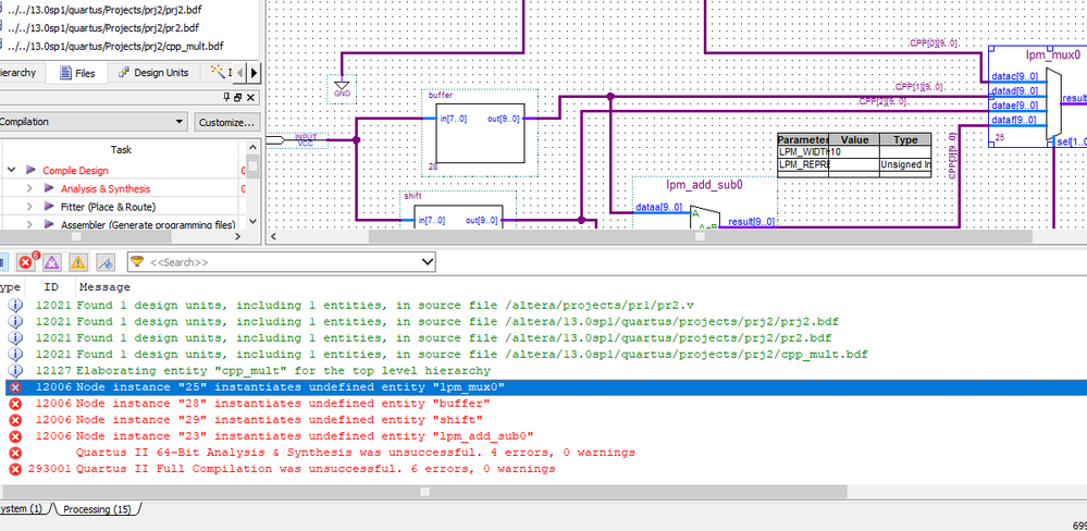

Error in compilation
Error (12006): Node instance "25" instantiates undefined entity "lpm_mux0"
Error (12006): Node instance "28" instantiates undefined entity "buffer"
Error (12006): Node instance "29" instantiates undefined entity "shift"
Error (12006): Node instance "23" instantiates undefined entity "lpm_add_sub0"
I am using quartus II 13.0 sp1

    In the pop-up Megafunction panel, there'll be a note as below check image:
    Make sure those bdf files are in the same directory with the project file (QPF).
    Or specify the library path to those bdf files located folder by go to:
    Assignments -> Settings -> Libraries
    Tools -> Options... -> Libraries
    Sheng
