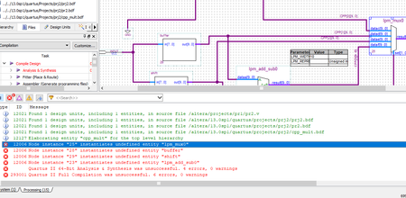

3 years agoError in compilation
Error (12006): Node instance "25" instantiates undefined entity "lpm_mux0" Error (12006): Node instance "28" instantiates undefined entity "buffer" Error (12006): Node instance "29" instanti...
ShengN_altera
3 years agoHi,
In the pop-up Megafunction panel, there'll be a note as below check image:
Make sure those bdf files are in the same directory with the project file (QPF).
Or specify the library path to those bdf files located folder by go to:
Assignments -> Settings -> Libraries
Tools -> Options... -> Libraries
Sheng
