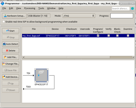

The problem seems to be caused by a SW issue..
Following the suggestion posted here
https://electronics.stackexchange.com/questions/239882/altera-cyclone-ii-jtag-after-as-programming
I installed libudev:i386:
$ sudo apt-get install libudev1:i386 $ sudo ln -sf /lib/x86_64-linux-gnu/libudev.so.1 /lib/x86_64-linux-gnu/libudev.so.0Then, after pluggin the board:
$ sudo killall jtagd $ jtagd --user-start $ jtagconfig 1) USB-Blaster [1-10] 020F30DD 10CL025(Y|Z)/EP3C25/EP4CE22The above script can be placed the bin directory of installation, for example /opt/intelFPGA_lite/20.1/quartus/bin/usbblaster.sh (yes, I switched to 20.1 version):
#!/bin/sh /usr/bin/killall jtagd /opt/intelFPGA_lite/20.1/quartus/bin/jtagd --user-start and udev rules set as follows:
SUBSYSTEMS=="usb", ACTION=="add", ATTRS{idVendor}=="09fb", ATTRS{idProduct}=="6001", MODE="0666", GROUP="plugdev", SYMLINK+="usbblaster", RUN+="/opt/intelFPGA_lite/20.1/quartus/bin/usbblaster.sh"Works like a charm.
Simon
I am not sure if this is due to the OS setup issue. We do have a debug tools where it is possible to debug JTAG chain issue.
Hello @JohnT_Intel ,
If you mean the Quartus JTAG chain test tool, it did not work, of course, without error reporting.
After applying the changes in the solution, the JTAG is successfully detected every time.
Simon
