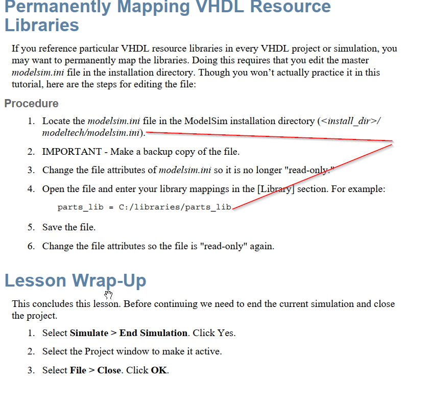

1-why at page 49 of modelsim Tutorial I have written the path to where the counter.vhd is found is still not seen by modelsim:
vsim work.test_counter # End time: 10:47:08 on Apr 16,2021, Elapsed time: 0:02:12 # Errors: 0, Warnings: 1 # vsim work.test_counter # Start time: 10:47:08 on Apr 16,2021 # Loading std.standard # Loading work.test_counter(only) # ** Warning: (vsim-3473) Component instance "dut : counter" is not bound. # Time: 0 ps Iteration: 0 Instance: /test_counter File: C:/Users/Desktop/FPGA/Tasks/testbench/tcounter.vhd # GetModuleFileName: The specified module could not be found.
and this my path in the modelsim.ini file:
[Library] std = $MODEL_TECH/../std ieee = $MODEL_TECH/../ieee verilog = $MODEL_TECH/../verilog vital2000 = $MODEL_TECH/../vital2000 std_developerskit = $MODEL_TECH/../std_developerskit synopsys = $MODEL_TECH/../synopsys modelsim_lib = $MODEL_TECH/../modelsim_lib sv_std = $MODEL_TECH/../sv_std ; Altera Primitive libraries ; ; VHDL Section ; part_lib = C:/Users/Desktop/FPGA/Tasks/resource_library/part_lib
