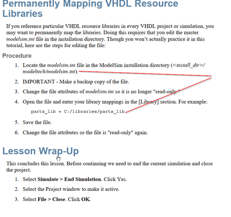

5 years ago** Warning: (vsim-3473) Component instance "dut : counter" is not bound?
So I am following the steps to create a path to library in vhdl with modelsim, my questions are ;
1-why at page 49 of modelsim Tutorial I have written the path to where the counter.vhd is found is ...
