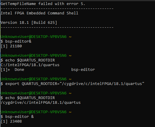

    As far as launching bsp-editor is concerned, you can run the Embedded_Command_Shell script (it will still fail with "error 5"). Once you see the Cygwin terminal prompt, and before attempting to launch bsp-editor, you will need to overwrite the path set for QUARTUS_ROOTDIR. As you can see in the picture below, the issue with the value of QUARTUS_ROOTDIR is that the path is as defined for Windows but ought to be defined with respect to the Cygwin shell, i.e. change the beginning of the path from "C:/" to "/cygdrive/c/". In other words, type the following command in the cygwin shell (provided that you took the default installation path for Quartus 18.1 in Windows).
    export QUARTUS_ROOTDIR="/cygdrive/c/intelFPGA/18.1/quartus"
    Now you should be able to launch bsp-editor without errors. To be clear, I understand that this (a) already has a solution, and (b) not a solution to your problem of the GetTempFileName error, but rather a workaround that enables you to continue to use the BSP editor. The point is to provide a workaround for anyone else who is put off by re-imaging their PC in order to use the development tools they need.

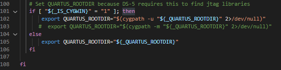

      BTW: if you're looking for a more permanent solution, you can edit the shell script 'env.sh' which can be found under the 'embedded' directory that is level with your quartus root. Change the -m flag to -u in the call to 'cygpath' which will give a unix path instead of a mixed path:
      export QUARTUS_ROOTDIR="$(cygpath -m "${_QUARTUS_ROOTDIR}" 2>/dev/null)"
      export QUARTUS_ROOTDIR="$(cygpath -u "${_QUARTUS_ROOTDIR}" 2>/dev/null)"
      snippet of env.sh below for reference
