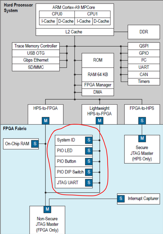

and i have not find the hardware abstract layer which describes the pheripherals in the FPGA(as showed in below image with red highlighted)

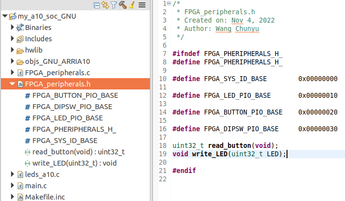

so i have to write the related HAL by myself as below image shows.

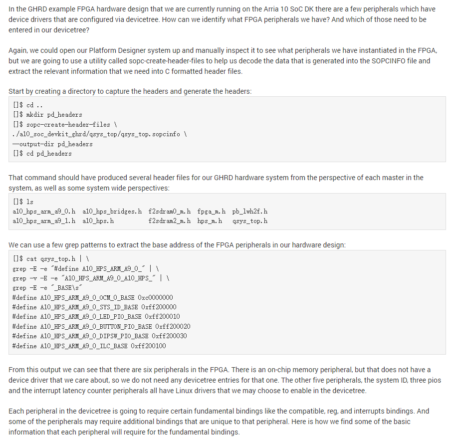

in fact, i just need the instructions as below iamge shows, and i found it on HOWTO Create a Devicetree for Arria 10 SoC | Documentation | RocketBoards.org
thank you for the support!

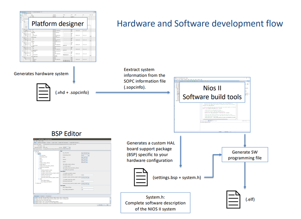

Below is the current flow diagram, the info that I have that we need to create our own HAL
Thank you,
Aliff
Thank you,
Aliff
