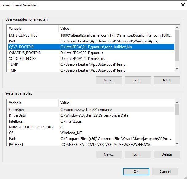

    Hi MF28,
    Check the QSYS_ROOTDIR is pointing to which quartus version
    example as below:
    Aik Eu

  • MF28's avatar
    MF28
    Hello Aik Eu!
    Sorry for the late answers.
    It is still not working with Quartus 21.1. However after reinstalling everything from Quartus 18.1 again and re-typing / re-generating the entire code without changing anything it suddenly worked. The Qsys Root Dir was fine but somehow it seemed to be missing some file which was not installed properly I guess.
    BR
    MF28
