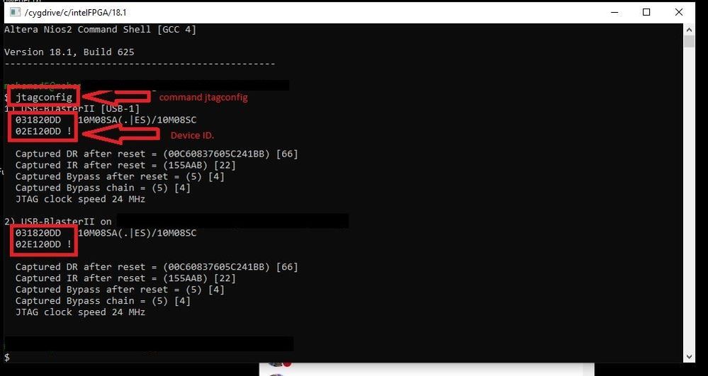

      Can you try to use command "jtagconfig"?
      and send the screenshot to me.
