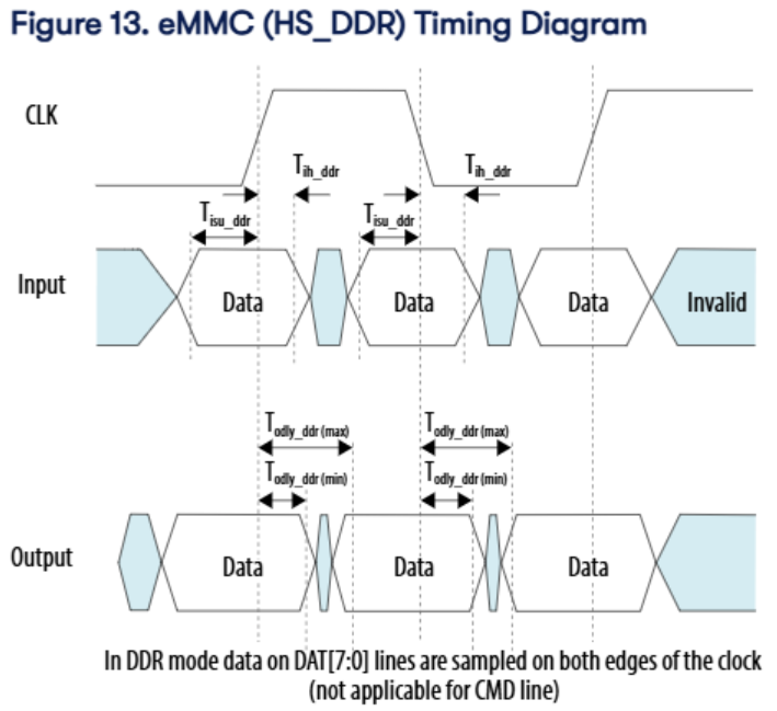

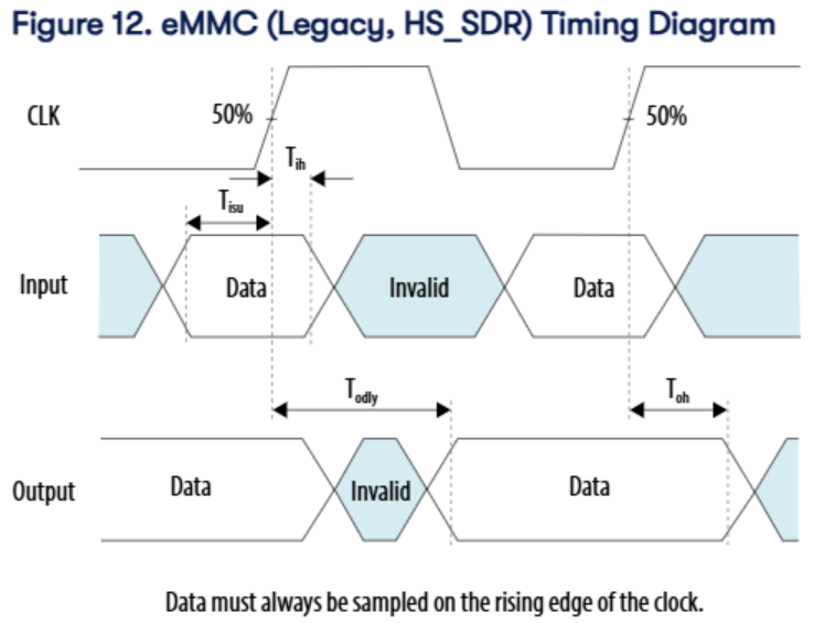

    Could you refer to the Agilex 5 datasheet under SD/EMMC timing characteristics (https://docs.altera.com/r/docs/813918/current/agilextm-5-fpgas-and-socs-device-data-sheet/agilextm-5-fpgas-and-socs-device-data-sheet)
    Example for legacy, HS_SDR
    There is also timing tables for the rest of the modes eg (HS,HS200, HS400). Could you refer to the document and see whether it addresses your timing question?

      I've gotten a reply on our factory on the your question as I was asking them whether Tco & Tsetup/hold is it correspond to the Tisu, Tih,  Todly etc. They would like to understand further on your query on what spec are you looking for , it is something like on Figure 12/13?

        Sorry for the delay, our factory team only provided the screenshots as per my previous comments as they only have these timing specs and mentioned that they would like to understand further on your query, what are the specs or data you're looking for.
