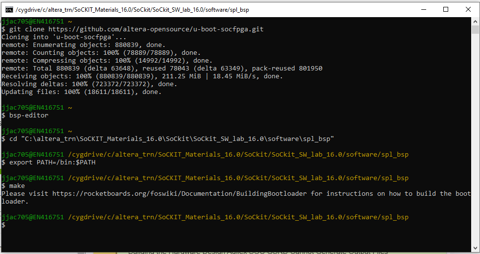

I attempted the SoC EDS as per the pdf SoC_software_lab_16.0.pdf on rocketboards.org. I was asked to see the link to create a u-boot-socfpga. In that, it was told to clone a github file which I did but when I tried to use the command 'make', I get the same issue again and again.
Kindly help me out of this.

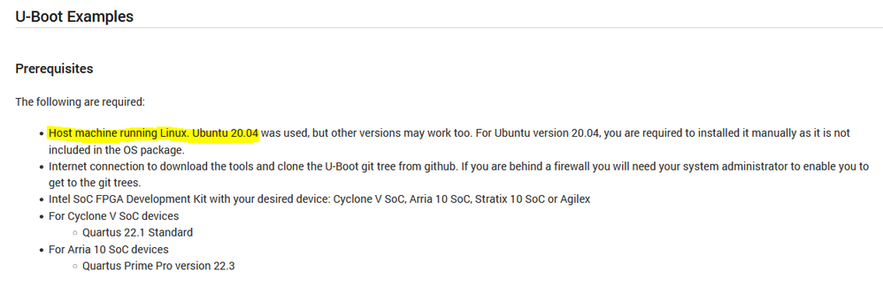

Hi jjac705,
I think the document you are referring to may not work if using later version of Quartus.
Refer to this link for building bootloader:
https://www.rocketboards.org/foswiki/Documentation/BuildingBootloaderCycloneVAndArria10

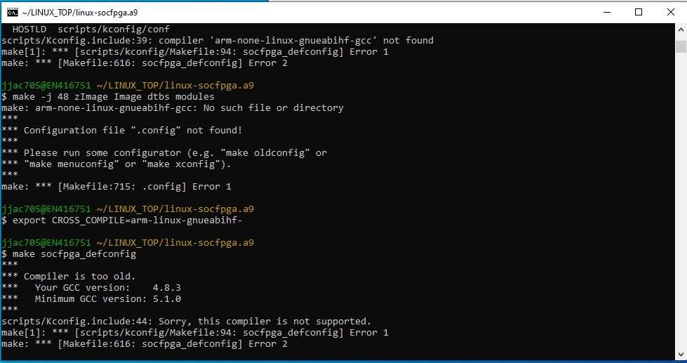

I have attempted to make the Linux kernel as per the instructions given in the link https://www.rocketboards.org/foswiki/Documentation/BuildingBootloaderCycloneVAndArria10?elq_cid=7076518_ts1673294693388&erpm_id=10201171_ts1673294693388. I have done this in the Embedded Command Shell.bat.
I am using Quartus Prime Standard 19.1.
When I put the command 'export CROSS_COMPILE=arm-none-linux-gnueabihf' and then make socfpga_defconfig, I got an error.
However, I changed to 'export CROSS_COMPILE=arm-linux-gnueabihf' and then did make socfpga_defconfig then it says that the compiler is old.
What can I do to get out of this?
Jerry Jacob
- aikeu
Hi jjac705,
In the building bootloader document, you will need to start with download and setup the toolchain first. example as below:
Depends on your requirement, you can build U-boot first without the Linux kernel to have the system boot up.
Download and setup the toolchain required for Cyclone V SoC and Arria 10 SoC:
tar xf gcc-arm-11.2-2022.02-x86_64-arm-none-linux-gnueabihf.tar.xz
rm gcc-arm-11.2-2022.02-x86_64-arm-none-linux-gnueabihf.tar.xz
export PATH=`pwd`/gcc-arm-11.2-2022.02-x86_64-arm-none-linux-gnueabihf/bin:$PATH
Aik Eu

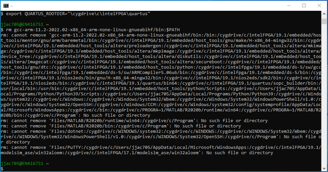

- jjac705
Hi Aikeu,
I attempted to use the above. When I used, rm gcc-arm-11.2-2022.02-x86_64-arm-none-linux-gnueabihf.tar.xz, I got an info where it says No such file or directory.
Jerry Jacob
- aikeu
Hi jjac705,
"rm gcc-arm-11.2-2022.02-x86_64-arm-none-linux-gnueabihf.tar.xz" is to remove the tar.xz files which you get from
"wget https://developer.arm.com/-/media/Files/downloads/gnu/11.2-2022.02/binrel/gcc-arm-11.2-2022.02-x86_64-arm-none-linux-gnueabihf.tar.xz" after that files have been extracted with "tar xf gcc-arm-11.2-2022.02-x86_64-arm-none-linux-gnueabihf.tar.xz".
The tar.xz file will not be required after it has been extracted so that line using the rm cmd is used to remove it.
Aik Eu
