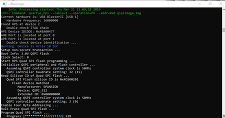

I'm transferring 64MB of qspiimage.img image to QSPI NOR S25FL512 flash on our custom board (uses A10SoC same as GHRD design). It takes a long time to finish the image transfer (>2hr). I’m fo...
