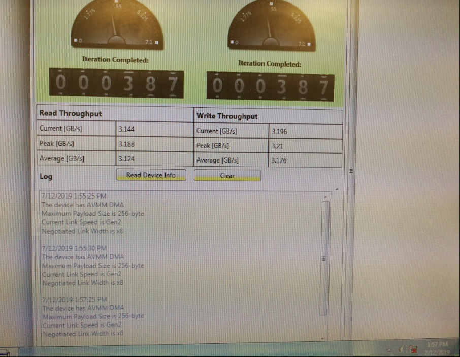

- BoonT_Intel
I just tested with my Window 7 64bits desktop and the GUI is working correctly. (Please note that it showing Gen2 because the slow that I am using only support Gen2).
Anyway, this show the GUI is working correctly.
