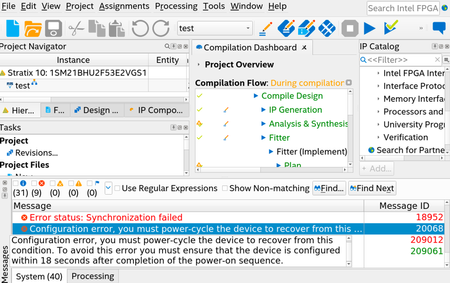

6 years agoProblem on downloading bitstream to a Stratix 10 MX board
Hi all, Now I'm trying to programming the Stratix 10 MX board with a simple test example (4-bit counter). Following are my hardware and software info: Software: Quartus Prime Pro 19.3 Hardware: St...
JohnT_Altera
6 years agoHi,
The board does not support MSEL changes using DIP Switches. In order to make the changes in MSEL then you need to modify the Weak-pull up and weak pull down of the resistor on the board.
