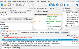

6 years agoProblem on downloading bitstream to a Stratix 10 MX board
Hi all, Now I'm trying to programming the Stratix 10 MX board with a simple test example (4-bit counter). Following are my hardware and software info: Software: Quartus Prime Pro 19.3 Hardware: St...

May I know if you are able to share with me your sof file?
- ZZhan1086 years ago
Sure. This sof file is generated by Quartus Prime Pro 18.0 patched with patch 0.13 Linux provided in the following link:
https://www.intel.com/content/altera-www/global/en_us/index/support/support-resources/knowledge-base/component/2018/why-does-my-stratix10-device-fail-to-configure-if-there-is-a-del.html
