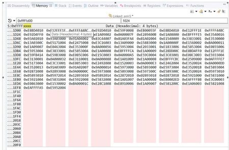

6 years agoOn-chip RAM unavailable over JTAG
There is a VERY SIMPLE example how to create and start a HPS based "Hello World" app on Cyclone V SOC : https://www.intel.com/content/www/us/en/programmable/documentation/lro1424280108409.html Debug...
- 6 years agoCheck if you have board boot a the full linux imange out of the flash. Change the board boot to SW3 to boot from SD flash and remove the card to allow the board to work. If still not working recreate a new simple project base on the version of SOCEDS you have installed currently. This will avoid possible incompatibility issue which is due to diff version of SOCEDS and project version. http://www.alterawiki.com/wiki/SoCEDSGettingStarted#Getting_Started_with_Baremetal_Project_Management
