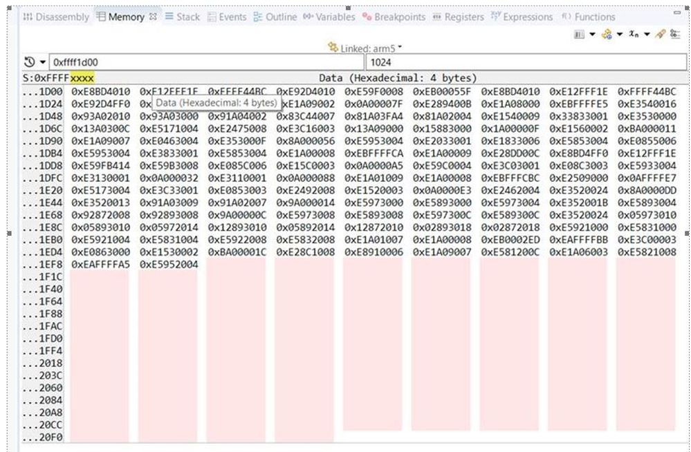

waitDebugger can access only in the range 0xFFFF0000-0xFFFF1FFF beginning with 0xFFFF2000 the OCRAM becomes unaccessible.

! Bus error on memory operationMemory view:
