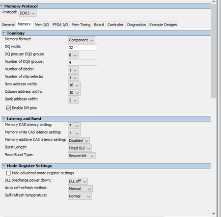

7 years agoNot able to boot the HPS after changing read CAS latency of DDR3
The above is the ddr config we kept Previously our CAS latency for read for our DDR3(MT41J128M16JT-125) in our board connected to ARRIA10 SOC (10as016e4f27e3sg) is 11 and we tried to change it...

Hi Sir, Incorrect CAS latency setting might cause the DDR calibration fail. However, from the log file, I don't see any failure include the booting also seem successful.
BoonT_Intel
6 years agoHi Sir, Incorrect CAS latency setting might cause the DDR calibration fail. However, from the log file, I don't see any failure include the booting also seem successful.
