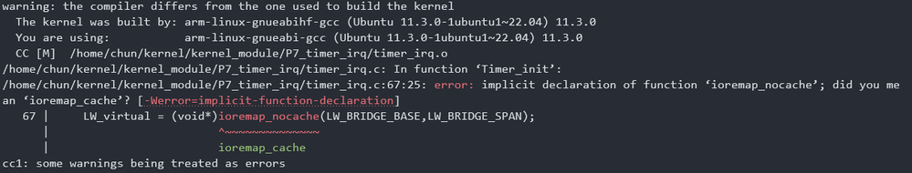

I want to use ioremap_nocache() function in Kernel module, but the following error occurred:
I've tried almoset all the branchs from 5.10 to 5.15
But the error still exist.
I wonder how to fix it.
Reguards.

    Yes I included <asm/io.h>,<linux/io.h>,<asm-generatic/io.h>
    And I checked socfpga-5-10 to socfpga-5-15 LTSs,maked them as zImage and make my module.
    The result is the same.
    My tool chain is arm-linux-gnueabi-
    Reguards.
    • CAlex's avatar
      CAlex
      I also changed the tool chain to arm-linux-gnueabihf-,but it never finish making the kernel.(for wrong comprocessor)

    The ioremap_nocache is no longer available starting from version 5.
    You should try out version 4.20.
    Jingyang, Teh
