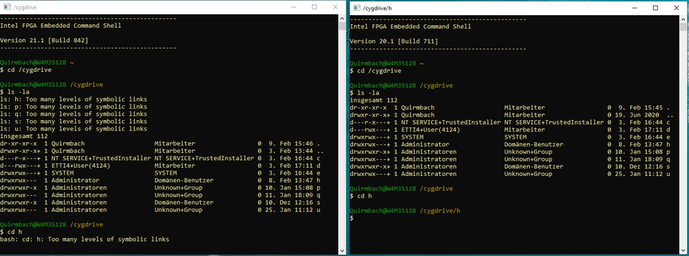

- GQUIR2
With "SoCEDSSetup-21.1.0.842-windows.exe" I get no access to my Network Drive.
For Network Drive h:
$cd h
bash: cd: h: Too many levels of symbolic links.
I have only access to local HDD Drive of my Computer.
With "SoCEDSSetup-20.1.0.711-windows.exe" I get access to my Network Drive.
$cd h
Quxxxxxch@W4Mxxxx8 /cygdrive/h

- GQUIR2
In the past it was possible, see attached Screenshot!
Intel FPGA Download Internet Page has now changed!
