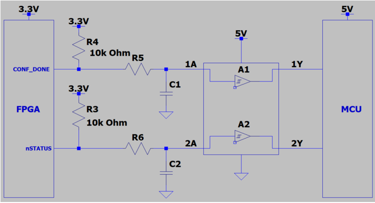

I am working on MAX 10. nSTATUS pin is required an external input buffer to support hot-socketing. I would like to know how to design the external input buffer Thank you

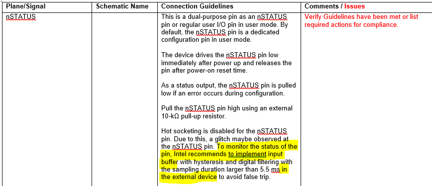

    • BSiri's avatar
      BSiri
      Thanks for your answer. I already knew that hot-socketing does not support nstatus and I found in the connection guideline that
      I have to implement an external input buffer. Is my schematic correct?
      Thank you
      • ShafiqY_Intel's avatar
        ShafiqY_Intel
        Hi Bsiri,
        You can use your schematic.

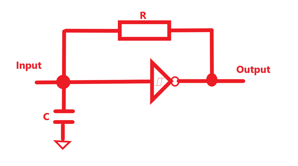

        However, based on my recommendation, I suggest you to parallel the Resistor (R). Refer to picture below (sorry for my ugly drawing... 😂 😂):
        1.When Input switched on the capacitor voltage is zero, thus the output is HIGH.
        • The high output voltage will start to charge C via R.
        • When the capacitor reach the higher threshold the inverter sees this as high voltage and the output will go LOW
        2.When output is LOW:
        • The capacitor will now start discharge to the low output through R.
        • When the capacitor reach the lower threshold the inverter sees this as low voltage and the output will go HIGH.
        3.The capacitor will start charge again and the whole thing repeats.
        I hope this will help.
