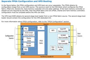

3 years agohow to use separated the FPGA configuration and HPS booting?
As below figure shows, we use the 10AS016 chip, and we have 2 EPCQ flashes on our board, one for HPS booting and the other for FPGA configuration. We stored the FPGA configure file in the FPGA side E...

Thanks, I see now, I will need to check on my side and get back to you.
