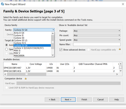

we are working on Startix-iv Intel Fpga Board. For this we needed installed this Software intel-quartus-ii-web-edition-design-software-version-13-0sp1-for-linux . While opening Quartus software we are unable to see Stratix IV on Device Family. According with document this version support Stratix-IV.
Please help me here to add Stratix-IV device family on Quartus-ii-web-edition.

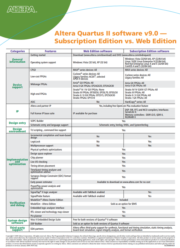

I checked Altera Quartus II software v9.0 on Intel website but This Version not available on Intel Site.
Could you please share link from where i can download Altera Quartus II software v9.0.
- RichardT_altera
Version 9 is obsolete. Version 13 is the oldest version that you can download now. I showed the chart as it show the difference between the web and subscription edition.

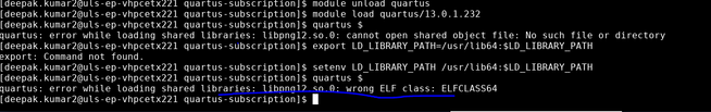

As discussed earlier, regarding Quartus 13 installation. I am facing an issue as shown below.
OS Version - RHEL-7.9
Kindly help me to resolve this issue.
Regards,Deepak
- RichardT_altera
It seems that your libpng12.so.0 installed is the incorrect architecture.
You may checkout this forum case.
Richard Tan

- deepak14
Now its working fine. Thank so much for your support
