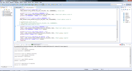

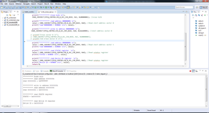

Hello, I am trying to access in read and write my EPCQL-1024 from simple soft running in NIOSII. I have the Altera Serial Flash Controller I configured in QUAD mode connected from its avl_csr and a...

7 years agoHi Chloe,
JTAG is the bridge to enable communication between Host PC and FPGA. Correct frequency is needed in order to establish a clean and correct timing waveform for JTAG signals. This is probably the reason that you don’t see any effect after you have performed write operation / erase operation. Once you have re-powered the board, the communication will become normal and you are able to see the action that you have done previously (erase sector or write specific data to specific address).
