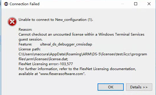

DS5:Cannot checkout an uncounted license within a Windows Terminal Services guest session.
when i use the evaluation license, it tells me there is something wrong.

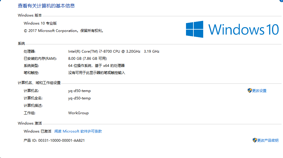

    Welcome to INTEL forum. To narrow down this issue, can you please provide me the latest of the following?
    1) .log file
    2) Machine OS information
    3) license.dat file

    Thanks for your update. May I know, are you accessing a machine over a remote desktop session? Referring to error message ( License Issue: Cannot checkout an uncounted license within a Windows Terminal Services guest session ) looks like you using remote session.
    From my understanding, your license is a fixed type license. Fix type license can’t support this feature. If you are accessing a machine over a remote desktop session, you need a Floating style license.
