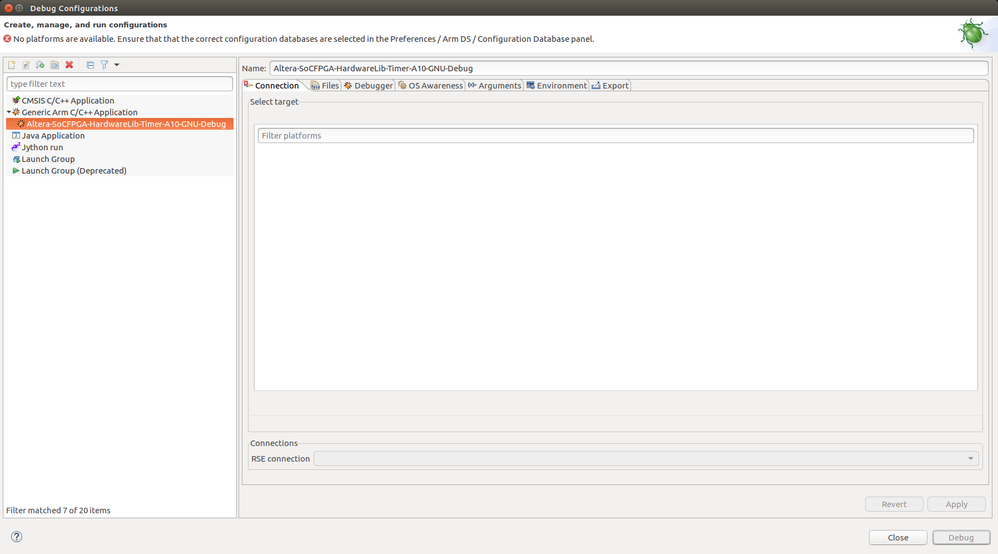

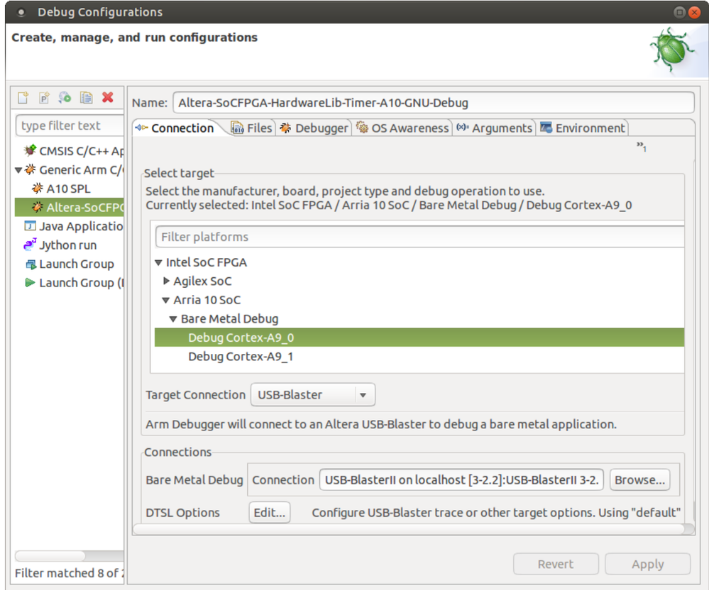

in debug configuration window i need to see all the Platforms like that:
But, in my debug configuration window i got nothing:
Anny help will be appreciated,

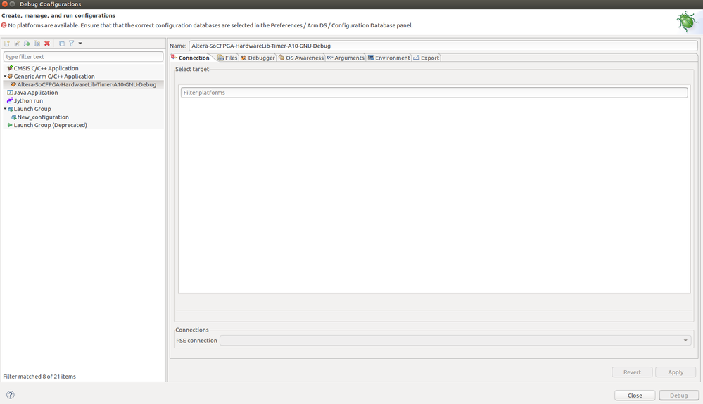

      It's the same link to rocketboards site that i was send in my previous message.
      I tried again to do the same thing, just to show you that the bug is still exist, this is what i got(again):
      The database is still empty.
      Tamir
