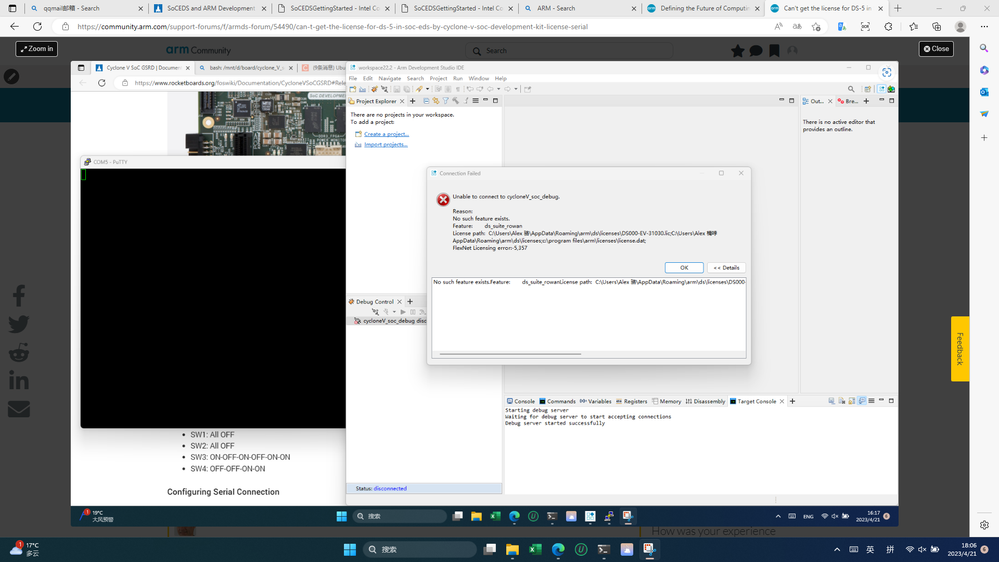

I got the issue on debug usb blast link,
I had 30 day free Golden edition license, but I got the debug license issue.
- Jeet14
Can you please try removing the space and other characters from the license path.
Let me know the status.
