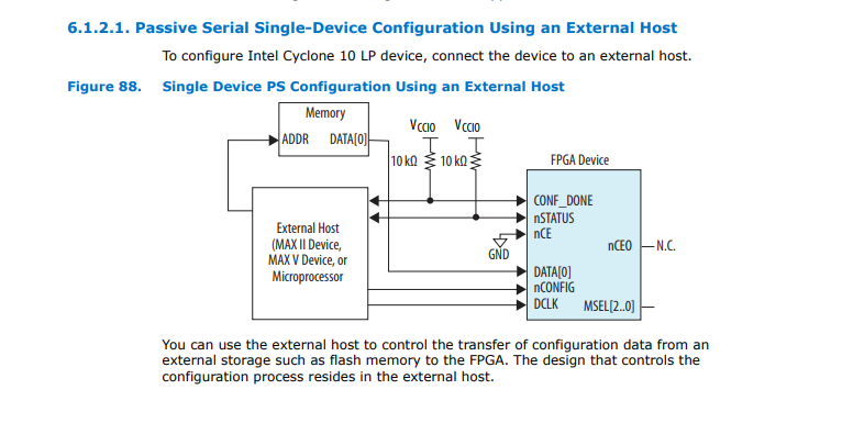

But my Doubt is still there Data0 pin in PS configuration is input data pin that is fine. But I wanted to ask Does it matters that the input source is a HOST controller or an external memory. As I got confused by looking at the below figure from Handbook where data input is from memory and all other control signals are from HOST controller.

As mention in the Cyclone 10 LP pin connection guidelines, DATA0 pin is dedicated configuration data input pin hence it can only be used for configuration not HOST controller or external. You will need to follow per recommended in the guidelines.

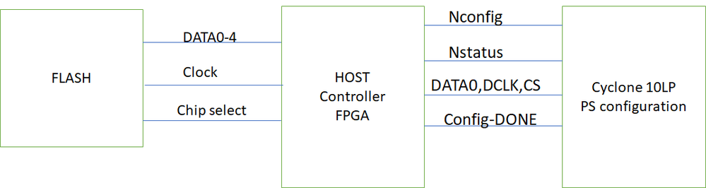

I have attached Block diagram of our connections kindly review once .

Sorry to tell you that we did the connection per shown in the handbook and follows the pin connection guidelines, hence it is recommended to follow Cyclone 10 LP pin connection guidelines to avoid any failure.
