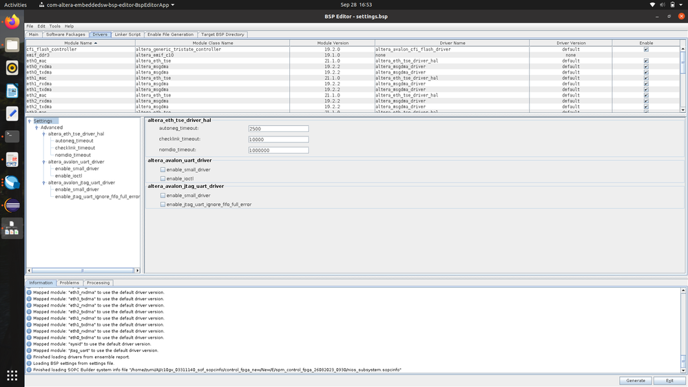

I am working on custom board Cyclone 10GX FPGA. I am able to detect the CFI flash driver name in BSP editor of Eclipse NiosII EDS. Now I need to test the CFI flash. Can anyone share me the link of C source code for the same. Thanks in advance.
