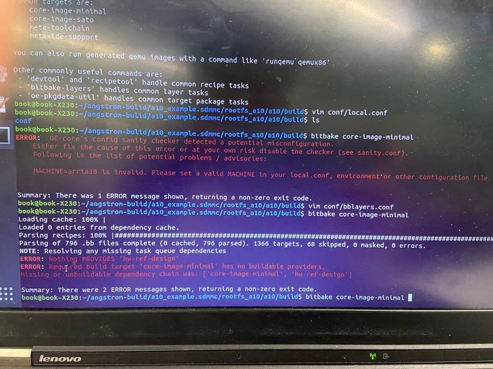

when i build Yocto Roofts,
bitbake core-image-minimal
i have try MACHINE="stratix10" or MACHINE="arria5".
It's all the same mistake.
ref to https://rocketboards.org/foswiki/Documentation/BuildingBootloader#Arria_10_SoC_45_Boot_from_SD_Card

Hi ,
Can you also try the steps mentioned in the below link and let us know the results.
https://rocketboards.org/foswiki/Documentation/BuildingYoctoOrAngstromForSoCFPGA
