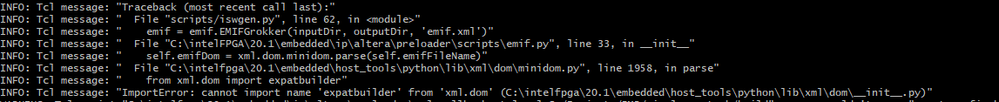

bsp-create-settings.exe fails with "ImportError: cannot import name 'expatbuilder' from 'xml.dom'"
Hi all,
I'm trying to generate the handoff files using bsp-create-settings.exe as explained here:
https://github.com/altera-opensource/u-boot-socfpga/blob/socfpga_v2021.07/doc/README.socfpga
But it fails with python not finding the correct libraries.
This is using SoCEDS 20.1.
If I run this in a Linux machine, a secondary unit, this works OK.
Windows:

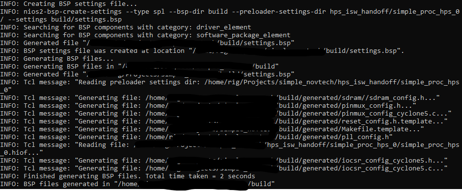

Linux:

- Alberto_F
Thanks for your reply Aik,
Would that workflow be ok vor Cyclone-V? I'm running on a Cyclone V platform.
I was able to run the script as well on a WSL2 environment in a Windows machine, so I have a workaround at the moment.
Cheers,
Alberto
